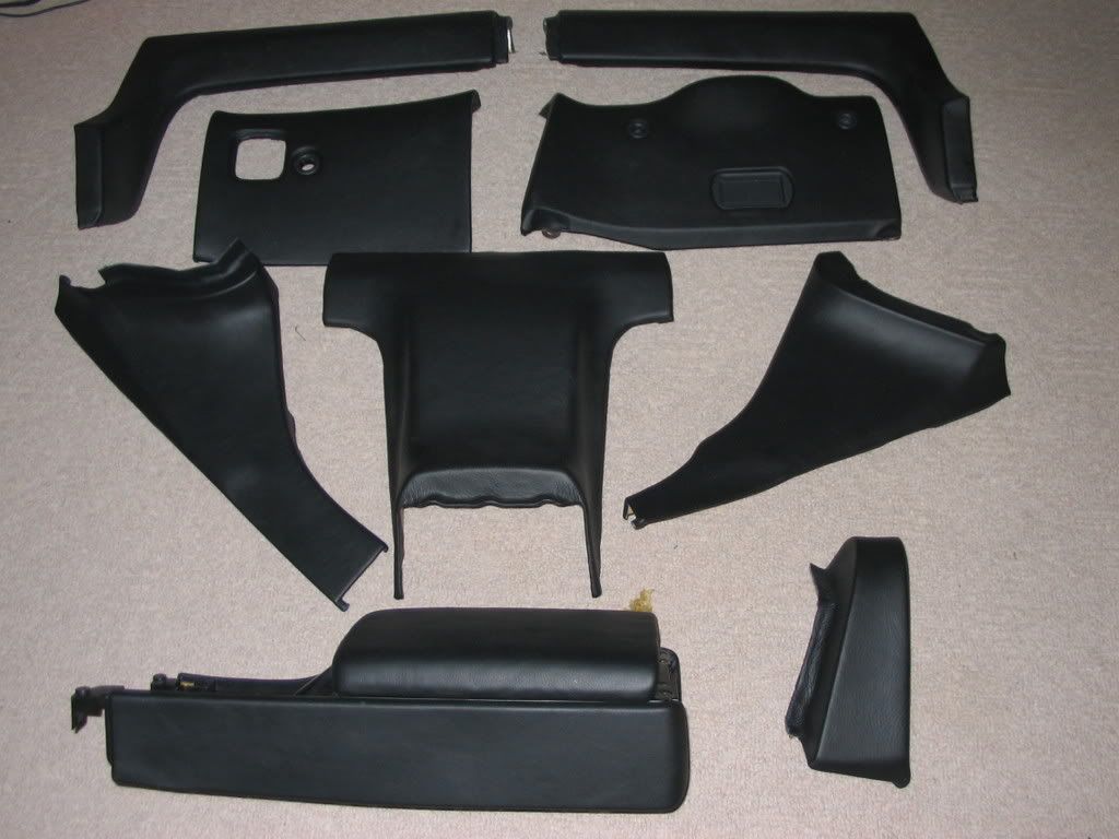

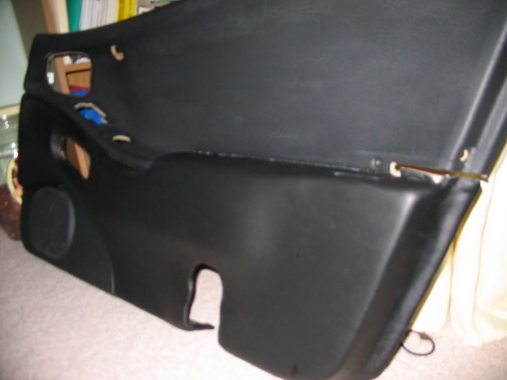

Anyway, here's some pics of the interior I just sold.
